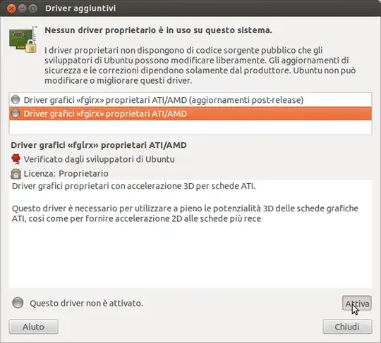

The best driver, Gallium 3D, should automatically be enabled and installed.
Try running a 3D game like Neverball or Neverputt, you can find both in Ubuntu Software Center.
If they don't work install fglrx (not the post-release update) with Additional Drivers in System Settings.
