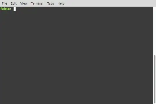

I have developed my own Bash Script (to undo the last APT commands), and now I'm looking for the best directory to install it.
Is the /usr/bin always the best choice?
Just for information this is my script:
https://gitlab.com/fabio.dellaria/apt-rollback
and this is a little demo:
