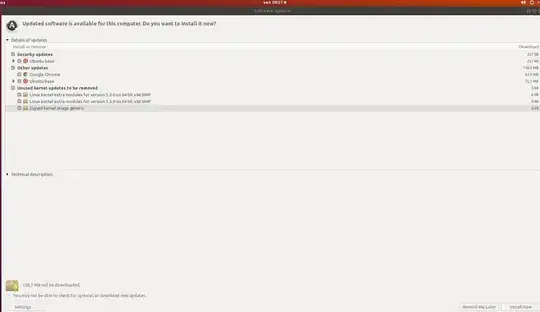

Last evening I made the requested packages upgrade for Ubuntu 18.04.4 Desktop. But now I'm not able to connect to the network anymore with the previous network configuration files. These are the packages upgraded:
