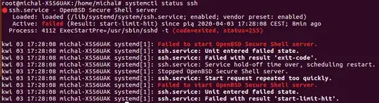

I want to check ssh status but I have fallowing error:
status error
I thought that problem can be with dependencies so I put
apt-get install -f
but I have this same problem
Failed to start OpenBSD Secure Shell server.
What is wrong?
