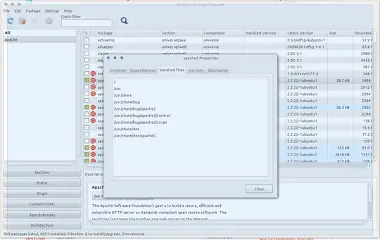

You can use synaptic to find all apache files and see where they are. First search for Apache, then right click on the package(s) and click properties. Select the installed files tab to see where the files are.
example
Apache stores its sites in /etc/www.
