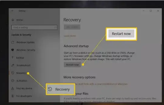

okay first of all you should enter the advanced startup options menu like this (without the boot flash is inserted) enter image description here

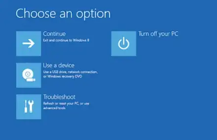

after you should get this screen and from this screen choose use a device enter image description here from there you should see the ubuntu partition
