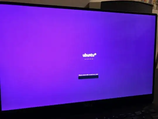

Any idea how to change the background image on the screen, where you enter encryption password? It's the noise-texture by default, the same as the default login screen background. Very dull.
I am running 19.10.
Image of the screen in question:
Essentially, when you are installing Ubuntu, you can choose to encrypt the whole HDD. If you do this, you will get this screen before the OS starts loading. I would like to change the this dull background to some custom image.

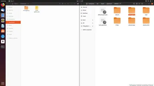

  1. Download the theme.
  2. copy it to /usr/share/plymouth/themes/ # here "mint-galaxy" is the directory in my case.

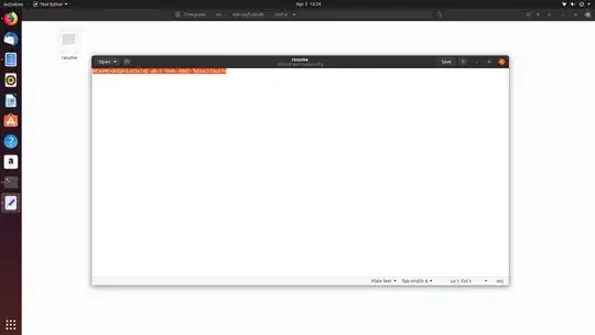

  1. now create a text file named resume with below content and place it in /etc/initramfs-tools/conf.d/ # Your UUID will be different. Change it in below.
Content:
RESUME=UUID=5a53e741-abcf-464e-866f-3d32c231ed7a

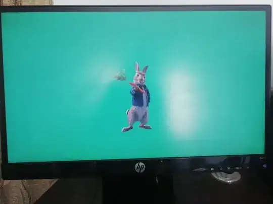

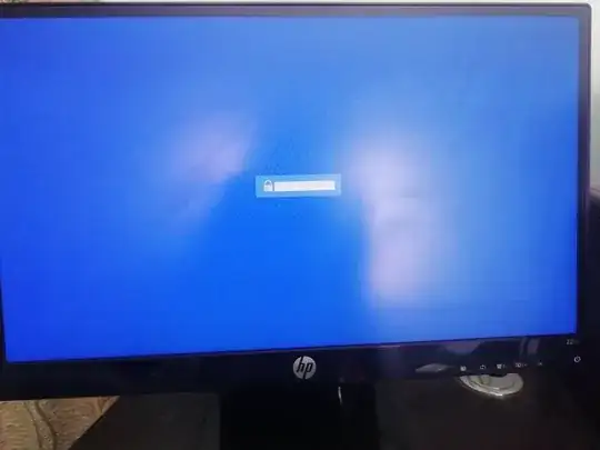

Images of Peter-Rabbit Plymouth Theme..
