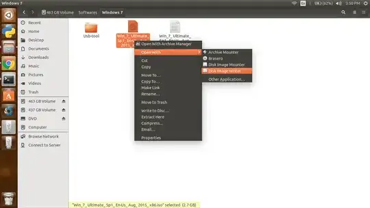

You can make a bootable USB without downloading any software. On a linux PC -
  1. Right click on the iso file and select open with and then click on disk image writer.
  2. Now select your usb drive and click on start restoring.
  3. Wait for 2-3 minutes.
  4. Your USB is bootable now and you can boot now.
