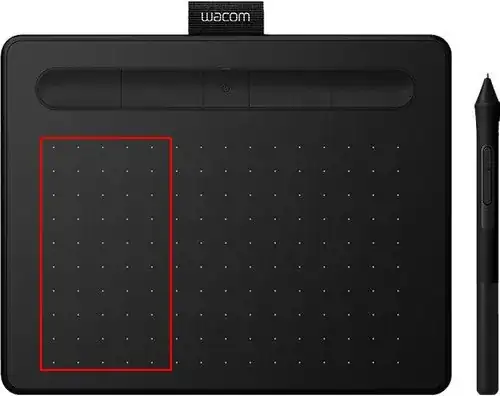

My new Wacom Intuos S connects to my Ubuntu laptop, and responds to input, but only its left half (or really, left third) works properly. In the image below I have marked the area that works properly.
Wacom Intuos S with red rectangle on left part of pad
If I move my stylus outside the rectangular area, my cursor still responds to vertical movement (i.e. moving my stylus still causes my cursor to go up and down) but no longer to horizontal movement (i.e. moving my stylus does not cause my cursor to move left to right).
