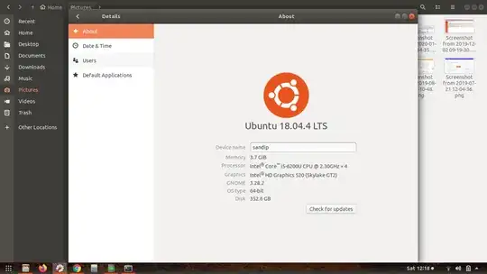

I want to use AMD Graphics which is dedicated in my HP laptop. In Ubuntu 18.04 default Intel graphics is used.
When I execute the command:
lspci -nn | grep -E 'VGA|Display'
it shows:
00:02.0 VGA compatible controller [0300]: Intel Corporation Skylake GT2 [HD Graphics 520] [8086:1916] (rev 07)
01:00.0 Display controller [0380]: Advanced Micro Devices, Inc. [AMD/ATI] Sun XT [Radeon HD 8670A/8670M/8690M / R5 M330 / M430 / R7 M520] [1002:6660] (rev 83)
Please let me know how to change it from intel to AMD.
