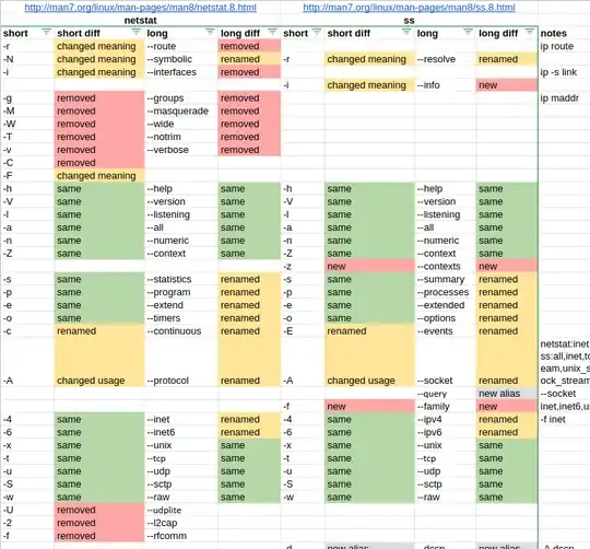

I've made a comparison table (in Google Docs) (light HTML link) for converting between netstat and ss arguments. It's too big to include and update it here.
google doc screenshot
The short version of difference between short arguments is:
Arguments that require attention: r N i g M W T v C F c A U 2 f
Arguments that are safe to leave as is: h V l a n Z s p e o 4 6 x t u S w

I stumbled across this post while researching netstat -> ss conversion. Outstanding table but I wanted to point out one thing in particular... the man page description for the netstat -s command option states, "Display summary statistics for each protocol". ss -s option in the man page states, "Print summary statistics. This option does not parse socket lists obtaining summary from various sources. It is useful when amount of sockets is so huge that parsing /proc/net/tcp is painful." These two command options return EXTIRELY different information.
