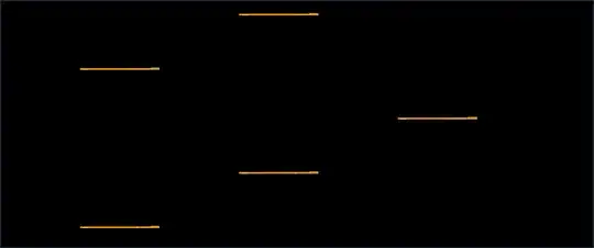

I am using mpv to play my mkv and other format files like ogv, mpg, mpeg2, mp4, etc.
After upgrading all the Software in my system, I started having this kind of screen instead of the video itself.
Other video players have similar behavior becoming unresponsive after few seconds and throwing high processor loads, but it seems that they are looking for a codec, plugin or something in order to do a good job, but they aren't reaching it.

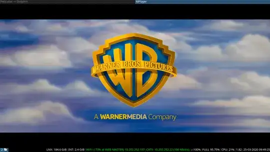

mplayer
Seems to be the only way I can play this videos, with some errors like wrong video duration.
enter image description here This video was only played by using the next:

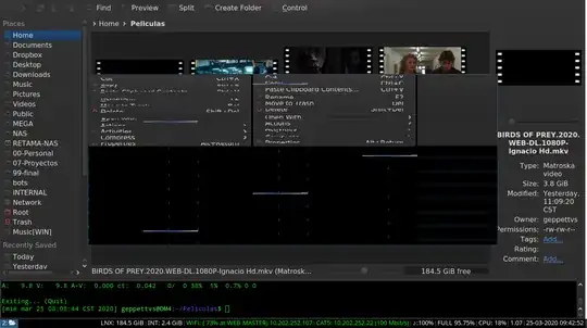

mpv
enter image description here Please notice the mpv screen is the black square in the middle of the screenshot.

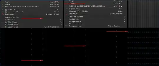

enter image description here I mean: this square.

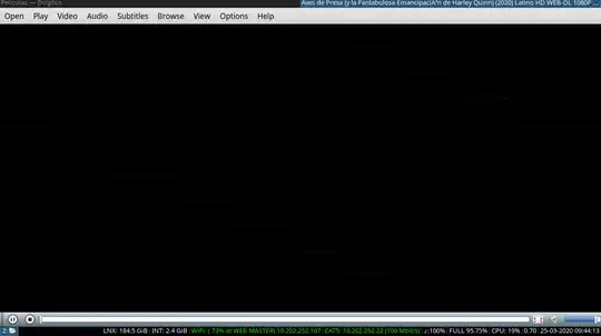

smplayer
enter image description here This is smplayer with the same video, you can notice some weird artifacts instead of the video.

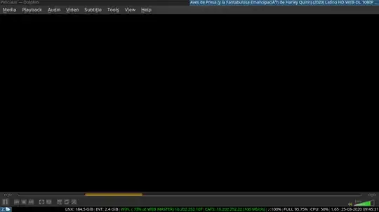

vlc
enter image description here VLC shows a black screen and a line running from left to right, like searching for the proper video codec or something, becoming unresponsive after some seconds.

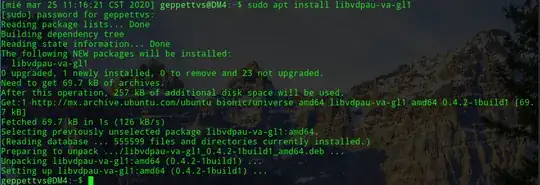

libvdpau-va-gl1
As @nobody asked, I checked if libvdpau-va-gl1 is installed in my system, resulting that I didn't have it.
After installing I tried to open the video file resulting in a more clean layout but no full video so far.
Thank you a lot for your wish to help.

We could revive at least mpv. By installing libvdpau-va-gl1.
Failed to open VDPAU backend libvdpau_va_gl.so: cannot open shared object file: No such file or directory
Next step was to update the system complete. Then we created a small $HOME/.config/mpv/config with this content.
vo=vaapi  #use vaapi for hardware decoding
hwdec=vaapi # maybe not longer required
ao=pulse #use pulse for audio overview gives mpv --audio-device=help
More options can be read in
zless /usr/share/doc/mpv/mpv.conf.gz
