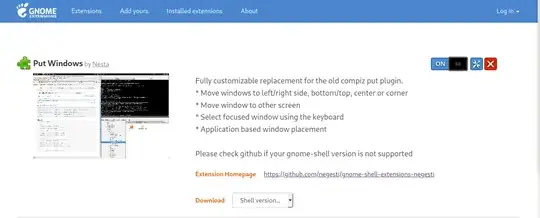

You can do this with the Gnome Extension Put Windows.
Press the left Win key and on the Numberpad 7/9/1/3 to place the active window in the upper left/upper right/lower left and lower right respectively.
You can install Gnome Extensions by following the instructions in this reference: https://linuxconfig.org/how-to-install-gnome-shell-extensions-on-ubuntu-18-04-bionic-beaver-linux
