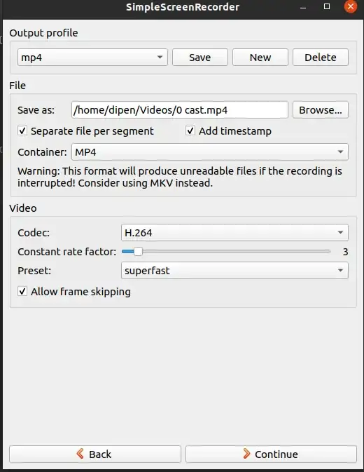

You can with below configs.
  • Container MP4
  • Video -> Codec: H.264
Here is screenshot of that config
