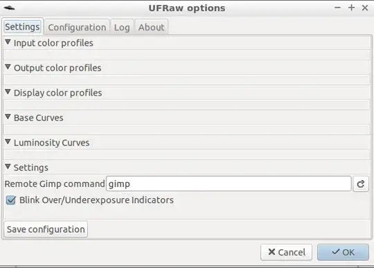

I have tried looking at the UFRaw options, but they are practically blank! enter image description here

Unlike typical programs which provide a save dialog when you actually try to save, UFRaw hides the save information under a tab.
In the above image, note that the second from right "tab" (the folder icon) is selected. This provides the ability to change the file type and specify JPEG parameters.
Note that when I save, the program silently exits after saving, which is also non-intuitive.
