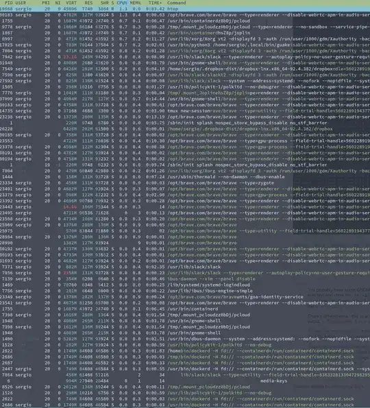

I'm having some issues with CPU usage when using wireless connection on my laptop.
This has never happened on wired connection, therefore I'm assuming wifi connection is somewhat related.
top says that most resources are used by gnome-shell, browser, and some kworker processes.
Situation also gets worse the more network resources are used (for example if I start a download). Here's an htop screen, as soon as I started a download several gnome-shell processes showed very high cpu usage: enter image description here

UPD2 htop in idle state: enter image description here

Holy !@#$% Batman. You've got WAY too manu GNOME Shell extensions, and many of them are duplicated in both places where extensions should exist.
System extensions are seen with ls -al /usr/share/gnome-shell/extensions should only contain these (19.10):
drwxr-xr-x 2 root root 4096 Nov  2 14:36 desktop-icons@csoriano
drwxr-xr-x 3 root root 4096 Nov  2 14:36 ubuntu-appindicators@ubuntu.com
drwxr-xr-x 3 root root 4096 Mar 12 16:22 ubuntu-dock@ubuntu.com
User extensions are normally seen via ls -al ~/.local/share/gnome-shell/extensions.
Remove the duplicates in /usr/share/gnome-shell/extensions.
Then restart GNOME Shell, or better yet, just reboot.
Then temporarily turn OFF ALL remaining extensions at https://extensions.gnome.org/local/ and retest your system. Turn ON only one extension at a time during testing. Monitor the top command, and GNOME Shell CPU usage should be less than 2%. The goal would be to only have 5-6 extensions enabled max. Ditch the rest.
