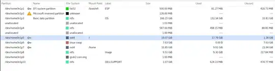

Here is a list

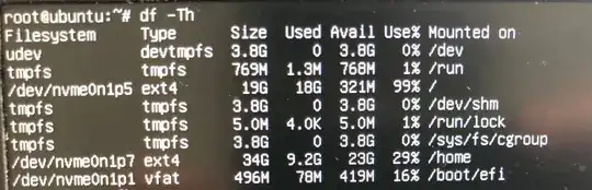

I want to shrink my /home to about 15G, and then extend my / to fill up that remaining space.
How can I do this?
In GParted, I can't seem to shrink /home because there is no free space after it I assume
The same goes for extending /

Note: You really need a larger HDD/SSD
Make sure that you have a good backup of your important Ubuntu files, as this procedure can corrupt or lose data.
Keep these things in mind:
  • always start the entire procedure with issuing a swapoff on any mounted swap partitions, and end the entire procedure with issuing a swapon on that same swap partition
  • a move is done by pointing the mouse pointer at the center of a partition and dragging it left/right with the hand cursor
  • a resize is done by dragging the left/right side of a partition to the left/right with the directional arrow cursor
  • if any partition can't be moved/resized graphically, you may have to manually enter the specific required numeric data (don't do this unless I instruct you to)
  • you begin any move/resize by right-clicking on the partition in the lower pane of the main window, and selecting the desired action from the popup menu, then finishing that action in the new move/resize window
Do the following...
Note: if the procedure doesn't work exactly as I outline, STOP immediately and DO NOT continue.
  • boot to a Ubuntu Live DVD/USB
  • start gparted
  • resize the right side of /dev/nvme0n1p7 (home) and reduce that partition by 5-10G
  • move the /dev/nvme0n1p7 (home) partition all the way right
  • move the /dev/nvme0n1p6 (swap) partition all the way right
  • resize the right side of /dev/nvme0n1p5 (/) all the way right
  • click the Apply icon
