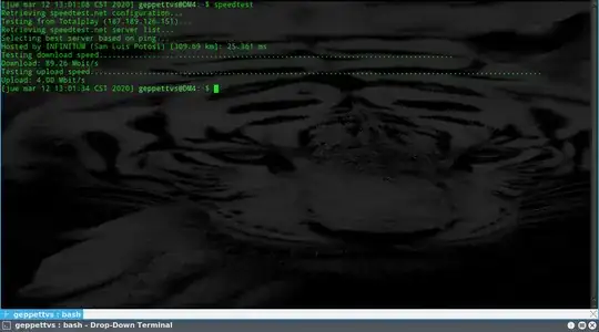

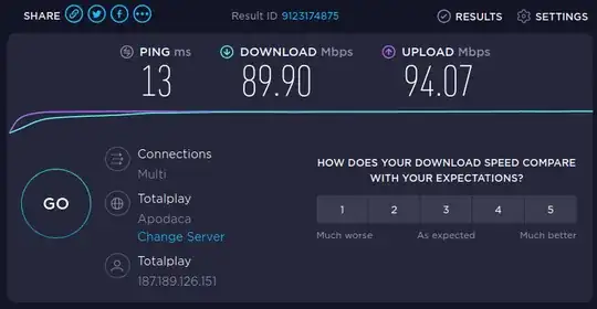

My connection is showing different speed when running speed tests from terminal emulator, TTY and compared to what the speedtest.net page is showing on a web browser.
Screenshots here:
Firefox results on speedtest.net
Results on Yakuake, using the speedtest command in a terminal. TTY results are the same.
As you can see, the web browser shows I have 94.07 Mbps upload but the terminal shows only 4 Mbit/s.

From the speedtest-cli repository:
There is the potential for this tool to report results inconsistent with Speedtest.net. There are several concepts to be aware of that factor into the potential inconsistency:
    1. Speedtest.net has migrated to using pure socket tests instead of HTTP based tests
    2. This application is written in Python
    3. Different versions of Python will execute certain parts of the code faster than others
    4. CPU and Memory capacity and speed will play a large part in inconsistency between Speedtest.net and even other machines on the same network
Issues relating to inconsistencies will be closed as wontfix and without additional reason or context.
So this is a known problem.
Answers to a similar question at SuperUser seem to indicate that more recent versions (i.e. clone the Git repo and buid from there) are better but not yet perfect.
