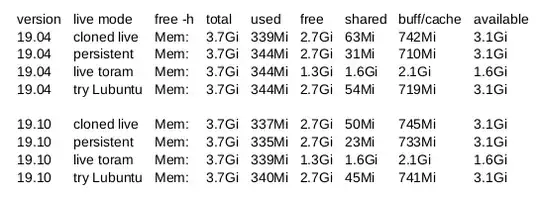

Test results
I found no unexpected behaviour when testing Lubuntu 19.04. For that reason I am rather sure that those results can also represent Lubuntu 18.04.x LTS.
I also tested Lubuntu 19.10, which has a modified mechanism in the package casper, and can be expected to behave in a different way. These results should also represent Focal Fossa to be released as Lubuntu 20.04 LTS.
Summary
The main difference is the free memory in case #3 in both versions (19.04 and 19.10), and the reason is that the boot option toram was used in that case. It means that the [whole] image of the iso file is copied to RAM. Otherwise there is no significant difference in the usage of RAM.
Details
  • Target computer A laptop with Intel i5 generation 3 CPU and 4 GB RAM
  • Explanation of the list above:
    • 'cloned live' - a live drive created by cloning from the iso file
    • a persistent live drive made with mkusb (and 67% selected for persistence)
      • 'persistent' - the menu option 'Start Lubuntu - persistent live'
      • 'live toram' - the menu option 'Start Lubuntu - live-only to RAM
      • 'try Lubuntu' - the menu option 'Start Lubuntu' which matches the standard alternative of a cloned drive
    • the remaining part of the list is output from free -h
      • 'total' - total amount of RAM
      • 'used' - RAM used by programs (in this case after boot and opening a terminal window)
      • 'free' - RAM not yet used
      • 'shared' - RAM shared
      • 'buff/cache' - RAM used for buffering (e.g. during writing) which has low priority.
      • 'available' - RAM available for running new programs

NAME   FSTYPE   LABEL               MOUNTPOINT                 SIZE MODEL
loop0  squashfs                     /rofs                      1.5G
sda                                                           14.6G Extreme
├─sda1 ntfs     usbdata             /media/lubuntu/usbdata     4.2G
├─sda2                                                           1M
├─sda3 vfat     usbboot                                        244M
├─sda4 iso9660  Lubuntu 19.04 amd64 /cdrom                     1.6G
└─sda5 ext4     casper-rw           /media/lubuntu/casper-rw   8.6G
sdb                                                             15G Transcend_16GB
└─sdb1 vfat     KEEP_ME             /media/lubuntu/KEEP_ME      15G
sr0                                                           1024M TSSTcorp_CDDVDW_SN-208AB
sr1                                                             11M AutoRun_Disk
zram0                               [SWAP]                   478.2M
zram1                               [SWAP]                   478.2M
zram2                               [SWAP]                   478.2M
zram3                               [SWAP]                   478.2M
df -h ##########
Filesystem      Size  Used Avail Use% Mounted on
udev            1.9G     0  1.9G   0% /dev
tmpfs           383M  1.4M  382M   1% /run
/dev/sda4       1.6G  1.6G     0 100% /cdrom
/dev/loop0      1.5G  1.5G     0 100% /rofs
/cow            1.9G   24M  1.9G   2% /
tmpfs           1.9G  6.3M  1.9G   1% /dev/shm
tmpfs           5.0M  4.0K  5.0M   1% /run/lock
tmpfs           1.9G     0  1.9G   0% /sys/fs/cgroup
tmpfs           1.9G     0  1.9G   0% /tmp
tmpfs           383M  8.0K  383M   1% /run/user/999
/dev/sdb1        15G  3.4G   12G  23% /media/lubuntu/KEEP_ME
/dev/sda5       8.5G   75M  8.0G   1% /media/lubuntu/casper-rw
/dev/sda1       4.3G   23M  4.3G   1% /media/lubuntu/usbdata
free -h ##########
              total        used        free      shared  buff/cache   available
Mem:          3.7Gi       344Mi       2.7Gi        54Mi       719Mi       3.1Gi
Swap:         1.9Gi          0B       1.9Gi
Output for Lubuntu 19.10
lsb_release -a ########################################
Distributor ID: Ubuntu
Description:    Ubuntu 19.10
Release:    19.10
Codename:   eoan
cat /proc/cmdline ##########
file=/cdrom/preseed/lubuntu.seed initrd=/casper/initrd quiet splash ---
sudo lsblk -o name,fstype,label,mountpoint,size,model ##########
sdb    iso9660  Lubuntu 19.10 amd64                         14.8G SS3
├─sdb1 iso9660  Lubuntu 19.10 amd64 /cdrom                   1.6G
├─sdb2 vfat     Lubuntu 19.10 amd64                          3.9M
└─sdb3 ext4     casper-rw           /var/crash              13.2G
sdc                                                           15G Transcend_16GB
└─sdc1 vfat     KEEP_ME             /media/lubuntu/KEEP_ME    15G
zram0                               [SWAP]                 477.3M
zram1                               [SWAP]                 477.3M
zram2                               [SWAP]                 477.3M
zram3                               [SWAP]                 477.3M
df -h ##########
tmpfs                         382M  6.2M  376M   2% /run
/dev/sdb1                     1.6G  1.6G     0 100% /cdrom
/cow                          1.9G   17M  1.9G   1% /
/dev/disk/by-label/casper-rw   13G   41M   13G   1% /var/log
tmpfs                         1.9G  6.7M  1.9G   1% /dev/shm
tmpfs                         382M  8.0K  382M   1% /run/user/999
/dev/sdc1                      15G  3.4G   12G  23% /media/lubuntu/KEEP_ME
free -h ##########
Mem:          3.7Gi       337Mi       2.7Gi        50Mi       745Mi       3.1Gi
Release:    19.10
Codename:   eoan
BOOT_IMAGE=(hd0,gpt4)/casper/vmlinuz file=/cdrom/preseed/lubuntu.seed quiet splash persistent ---
sdb                                                           14.6G Extreme
├─sdb1 ntfs     usbdata             /media/lubuntu/usbdata     4.2G
├─sdb2                                                           1M
├─sdb3 vfat     usbboot                                        244M
├─sdb4 iso9660  Lubuntu 19.10 amd64 /cdrom                     1.6G
└─sdb5 ext4     casper-rw           /media/lubuntu/casper-rw   8.6G
zram0                               [SWAP]                   477.3M
zram1                               [SWAP]                   477.3M
zram2                               [SWAP]                   477.3M
zram3                               [SWAP]                   477.3M
df -h ##########
tmpfs           382M  1.4M  381M   1% /run
/dev/sdb4       1.6G  1.6G     0 100% /cdrom
/cow            8.5G   60M  8.0G   1% /
/dev/sdb5       8.5G   60M  8.0G   1% /media/lubuntu/casper-rw
/dev/sdb1       4.3G   23M  4.2G   1% /media/lubuntu/usbdata
free -h ##########
Mem:          3.7Gi       335Mi       2.7Gi        23Mi       733Mi       3.1Gi
Release:    19.10
Codename:   eoan
BOOT_IMAGE=(hd0,gpt4)/casper/vmlinuz file=/cdrom/preseed/lubuntu.seed quiet splash toram nopersistent ---
sdb                                                                     14.6G Extreme
├─sdb2                                                                     1M
├─sdb4 iso9660  Lubuntu 19.10 amd64 /media/lubuntu/Lubuntu 19.10 amd64   1.6G
zram0                               [SWAP]                             477.3M
zram1                               [SWAP]                             477.3M
zram2                               [SWAP]                             477.3M
zram3                               [SWAP]                             477.3M
df -h ##########
/dev/shm        1.7G  1.6G   80M  96% /cdrom
/cow            1.9G   25M  1.9G   2% /
/dev/sdb5       8.5G   74M  8.0G   1% /media/lubuntu/casper-rw
/dev/sdb4       1.6G  1.6G     0 100% /media/lubuntu/Lubuntu 19.10 amd64
free -h ##########
Mem:          3.7Gi       339Mi       1.3Gi       1.6Gi       2.1Gi       1.6Gi
Release:    19.10
Codename:   eoan
BOOT_IMAGE=(hd0,gpt4)/casper/vmlinuz file=/cdrom/preseed/lubuntu.seed quiet splash ---
sdb                                                         14.6G Extreme
├─sdb2                                                         1M
└─sdb5 ext4     casper-rw           /var/crash               8.6G
zram0                               [SWAP]                 477.3M
zram1                               [SWAP]                 477.3M
zram2                               [SWAP]                 477.3M
zram3                               [SWAP]                 477.3M
df -h ##########
/dev/disk/by-label/casper-rw  8.5G   74M  8.0G   1% /var/log
free -h ##########
Mem:          3.7Gi       340Mi       2.7Gi        45Mi       741Mi       3.1Gi
