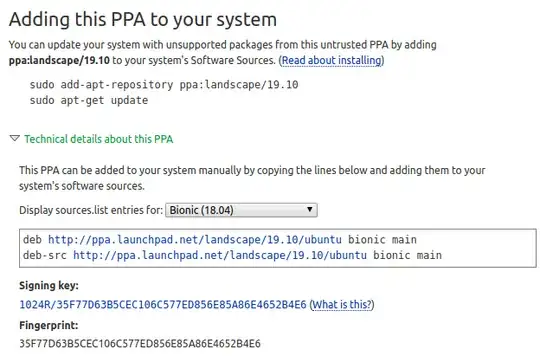

Err:6 https://ppa.launchpad.net/landscape/19.10/ubuntu bionic Release
PPA are accessible through clear http. Exception is for private-PPA which require authentication, but this isn't one of those. Also private PPAs are served from https://private-ppa.launchpad.net, thus likely explaining the SSL error you're getting.
I suggest to:
  1. remove those https ppa entries
  2. re-run sudo add-apt-repository --update ppa:landscape/19.10 so it can add back the ppa (as http, not https) and import the GPG signing key, if that hasn't been done.
simpoir
  • 580
Add the next record to your /etc/apt/sources.list manually:
deb http://ppa.launchpad.net/landscape/19.10/ubuntu bionic main
Then
sudo apt update && sudo apt install landscape-server-quickstart
Source
