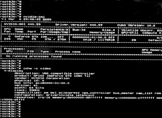

Black screen after login.. So I did an insanity check in Recovery mode (root).
nvidia-smi and lshw -c video can be seen in this snapshot.
Everything looks good, but the issue still persists.
Following Cannot get NVIDIA graphics card to work on Ubuntu 18.04, I disabled BIOS Secure boot and rebooted, but I was still unable to solve it.
