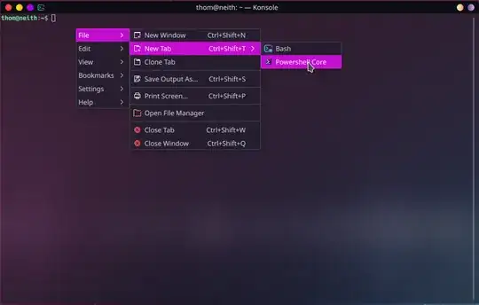

I've been trying to figure out how to set a short cut to launch a new tab, with a specific profile, but I can't seem to find an option. Effectively I want to emulate the highlighted Menu option below: enter image description here
I can set shortcuts to Profiles in the Manage Profiles Pane, however, that changes the active tab's profile; not what I want (and in this case doesn't change the environment to Powershell). I can launch a new tab with a shortcut, but that uses the Default profile.
Nothing in the Configure Shortcuts screen shouts out that it will do this, and a search of "Konsole open new tab with profile shortcut" drew me to questions like Pressing opens a new tab in Konsole, Is there a keyboard shortcut to open a new Konsole tab? and Switch profile in Konsole from command line?; none of which address what I'm trying to achieve.
Can you actually set a shortcut for launching a new tab for a specific profile in Konsole?
