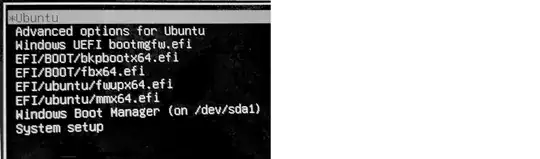

Later I reinstalled both Ubuntu and Windows 10, but GRUB shows multiple entries in its boot menu which I don't want. Below is a screen photo of my GRUB boot menu.
GRUB

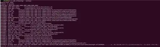

Boot manager drives:
Here is the text output:

Understand the relationship between the output of sudo efibootmgr and the Grub boot menu. Let us focus on the first part of the output:
BootCurrent: 0018
Timeout: 2 seconds
BootOrder: 0018,0019,0005,0006,0007,0008,0009,0004
and the Grub Menu screenshot:
The first line of the sudo efibootmgr tells us the default boot and this corresponds to the first line of the Grub Menu *Ubuntu. The * in the Grub menu indicates that this is selected by default.
From this, we learnt that 0018 in the sudo efibootmgr output corresponds to the *Ubuntu in the Grub menu.
We will ignore the second line of sudo efibootmgr. The third line tells us the boot order of 8 entries in the Grub menu:
0018 -> *Ubunu
0019 -> Windows UEFI bootmgfw.efi
0005 -> EFI/BOOT/bkpbootx64.efi
0006 -> EFI/BOOT/fbx64.efi
0007 -> EFI/ubuntu/fwupx64.efi
0008 -> EFI/ubuntu/mmx64.efi
0009 -> Windows Boot Manager (on /devsda1)
0004 -> System Setup
Now that we understand the relationship between the efibootmgr output and the Grub menu, we can form a strategy to delete the entries in the efibootmgr we don't need.
