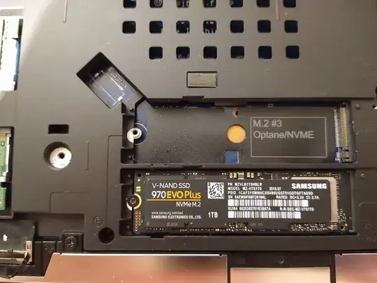

I recently bought a Dell Precision 7530 laptop which came preinstalled with Ubuntu 16.04 on a 500GB SATA drive. Later I bought a 1TB M2 PCIe NVMe SSD and installed it in a free slot in addition to the original SATA drive. enter image description here

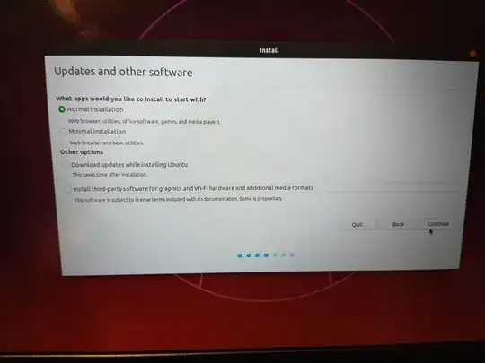

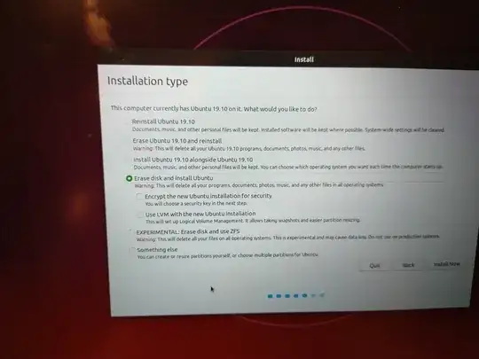

I then installed Ubuntu 19.10 on the new SSD drive. This did however not work, see my previous question.

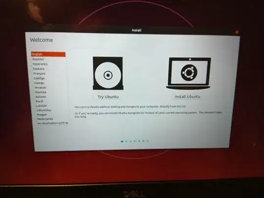

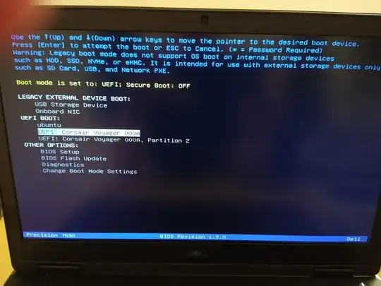

Later, I tried to physically remove the SATA drive and then it booted fine into Ubuntu 19.10 on the M2 PCIe SSD. Now I thought the problem was solved, and I bought a new 2TB M2 PCIe SSD from the same brand. I removed the 1TB SSD and replaced it with the 2TB SSD and then installed Ubuntu 19.10 (from USB): enter image description here
enter image description here enter image description here enter image description here enter image description here

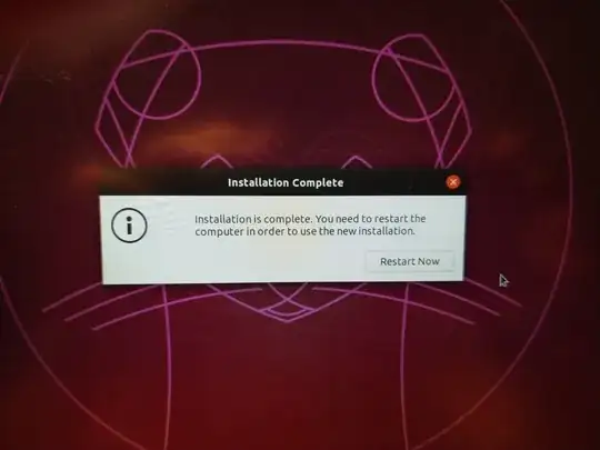

However, when I restarted the computer I got "No bootable devices found.": enter image description here

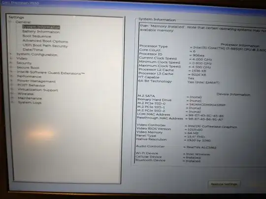

By pressing F2 I entered the BIOS:
which shows that the disk is present as "M.2 PCIe SSD-0". I find it very strange that the 1TB SSD can boot fine, whereas the 2TB SSD will not boot.

From the boot device selection screen, you need to install Ubuntu from the USB using the "UEFI BOOT" option:
it will not work if you choose the "LEGACY EXTERNAL DEVICE BOOT" option:
