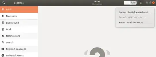

I am on Ubuntu 18.04. I tried to enable the wifi hotspot option "Turn on Wi-Fi Hotspot" from the wifi settings menu. But unfortunately, the option is disabled as shown in the picture below. How can I activate the option or is there any other way I can use my wired connection in my uUbuntu destop as wifi hotspot? Switching off/on the wifi doesn't activate the hotspot option.
Thanks

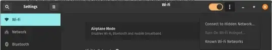

Was facing the same issue in Pop!_OS, which is Ubuntu based. On some tinkering, I found a solution which could work for you.
Image describing problem
enter image description here In the above picture, the option to 'Turn on Wi-Fi Hotspot' is disabled. To solve this, select 'Connect to hidden network' option present just above the 'Turn on Wi-Fi Hotspot' option.

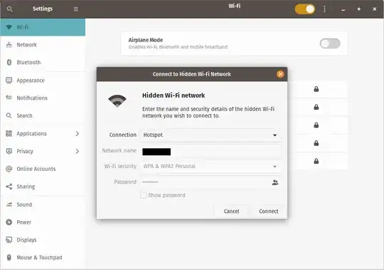

Then select the 'Hotspot' or a similar option in the 'connection' drop down menu. As shown in the below image. Your hotspot details will be auto populated in the below fields. Then click on 'Connect' button. And your Wi-Fi Hotspot will start.
solution image

From the image above it shows that your wifi is turned off. For you to be able to turn on your hotspot you first need to enable the wifi option and voila you will see the hotspot option enabled
