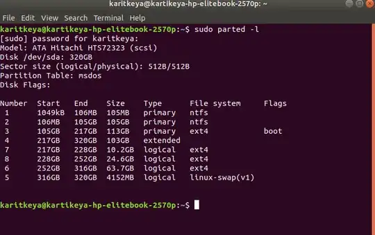

Here is a screenshot
Here is the text version of the screenshot.
I have space in my /home partition, I do not know if it is possible to reallocate sizes; is it practical?
I cannot use the swap partition as then I will have to unmount other partitions which includes home and root.

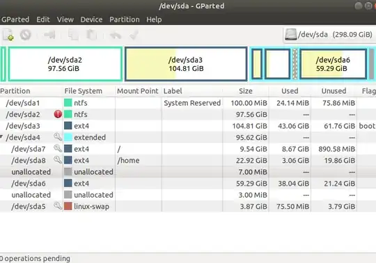

Edit: after applying the following commands, here is the screenshot of

Make sure that you have a good backup of your important Ubuntu files, as this procedure can corrupt or lose data.
Keep these things in mind:
  • always start the entire procedure with issuing a swapoff on any mounted swap partitions, and end the entire procedure with issuing a swapon on that same swap partition
  • a move is done by pointing the mouse pointer at the center of a partition and dragging it left/right with the hand cursor
  • a resize is done by dragging the left/right side of a partition to the left/right with the directional arrow cursor
  • if any partition can't be moved/resized graphically, you may have to manually enter the specific required numeric data (don't do this unless I instruct you to)
  • you begin any move/resize by right-clicking on the partition in the lower pane of the main window, and selecting the desired action from the popup menu, then finishing that action in the new move/resize window
Do the following...
Copy any last minute "few important images and documents" from sda6 to sda3 (as we'll delete sda6 (Elementary OS) later)
Note: if the procedure doesn't work exactly as I outline, STOP immediately and DO NOT continue.
  • boot to a Ubuntu Live DVD/USB
  • start gparted
  • delete /dev/sda6 partition (this will remove Elementary OS)
  • resize the right side of /dev/sda8 /dev/sda7 and add ~40G to /dev/sda8 /dev/sda7
    • this leaves about 20G unallocated, which will get added to /dev/sda6 later
  • move /dev/sda8 /dev/sda7 partition all the way to the right
  • resize the right side /dev/sda7 /dev/sda6 all the way to the right
    • this adds about 20G to the /
  • click the Apply icon
  • reboot # reboot the computer
  • sudo update-grub # update GRUB since the /dev/sda6 deletion
Update #1:
After deleting /dev/sda6, gparted has renumbered partitions, and then /dev/sda7 became /dev/sda6, and /dev/sda8 became /dev/sda7. Follow the same instructions, substituting the new partition numbers.

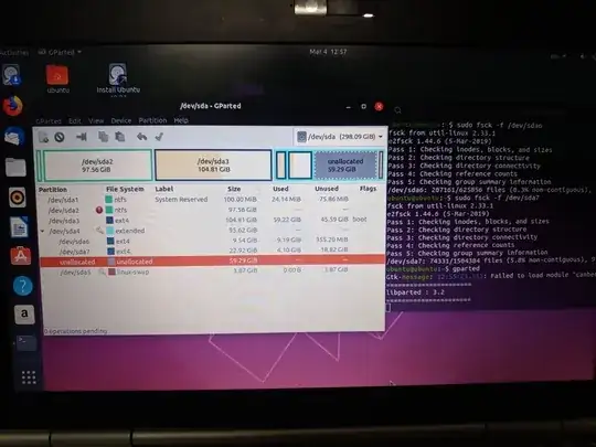

Boot to Ubuntu Live DVD/USB again. Start terminal and type:
  • sudo fsck -f /dev/sda6
  • sudo fsck -f /dev/sda7
  • give me a new screenshot of gparted
Update #3:
sudo umount /dev/sda2 # unmount this partition
sudo ntfsfix -d /dev/sda2 # try to fix ntfs partition
