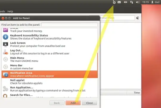

You can add the notification applet to the gnome-panel as shown in the picture.
To add, ALT+Win and right-click the gnome-panel to add the notification applet.

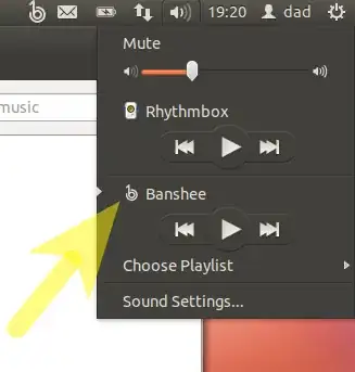

However, banshee is fully integrated in the sound-indicator, to perhaps the use of the notification icon is not required.

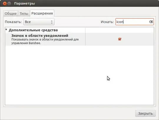

REMEMBER to enable it as extension from banshee's preferences.
Unknown
  • 333
Open Banshee UI. Go to Menu Edit > Preferences > Extensions.
There are several groups like communityExtensions,ContextPane...
Go to Utilies group. Notification Area sound Menu integration are the required options.
On my laptop these 2 options are exclusive. Notification Area gives a banshee icon in notification area. But has only one option to seek the play bar by hovering the mouse over the icon.
All other options are present in the menu on left click.
