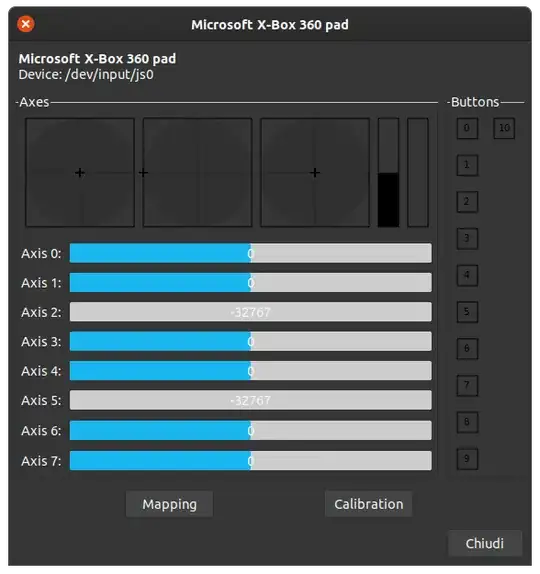

I have installed jstest-gtk, and it also sees the controller as an XBOX 360 pad, but clicking properties and pushing buttons on the controller does not make the corresponding software icons light up.
window of `jstest-gtk', having selected *properties* of the only available controller

The same issue was reported about xpad driver: https://github.com/paroj/xpad/issues/119 The python srcipt (fixcontroller.py) mentioned in the description solved the problem. Here is a copy of the script:
#!/usr/bin/env python3
import os import sys
try: import usb.core import usb.util except ImportError: print("First, install the pyusb module with PIP or your package manager.") else: if os.geteuid() != 0: print("You need to run this script with sudo") sys.exit()
dev = usb.core.find(find_all=True)
for d in dev:
    if d.idVendor == 0x045e and d.idProduct == 0x028e:
        d.ctrl_transfer(0xc1, 0x01, 0x0100, 0x00, 0x14)
finally: sys.exit()
