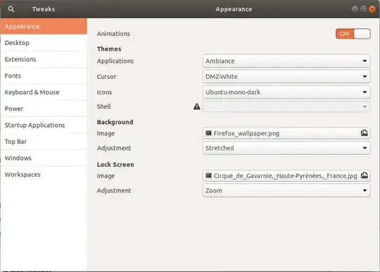

I've installed the Tweaks program and tried various themes, but none of the default ones display up/down arrows on scrollbars. I haven't found a setting in Tweaks that changes it. If I've missed it, please point it out.
tweaks program

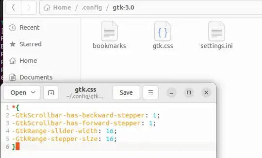

to add scrollbar arrows to all ubuntu themes: Create a file in /home/yourusername/.config/gtk-3.0/gtk.css containing the following:
-GtkScrollbar-has-backward-stepper: 1;
-GtkScrollbar-has-forward-stepper: 1;
-GtkRange-slider-width: 13;
-GtkRange-stepper-size: 13;
replace yourusername by your user name This applyed the arrows for me for many themes and programs but you will get small arrows. enter image description here
