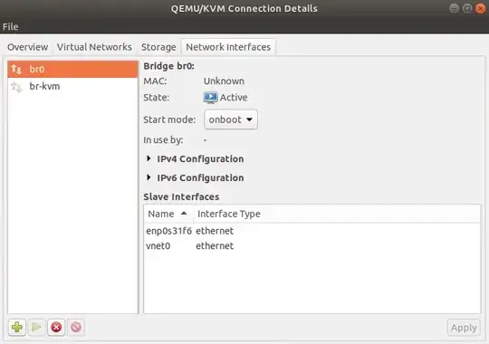

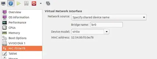

Edit2: Here is something else I checked (based on this post) is whether the network interface of my virtual machine is still associated to my bridge. To get the name of the interface, i did virsh domiflist LMS (with LMS being the hostname of my vm) and I got this:
Interface  Type       Source     Model       MAC
vnet0      bridge     br0        virtio      52:54:00:f0:0e:f8
It already says br0 there under source, but I'm not sure what exactly that means so I double checked using brctl show br0, which confirmed that vnet0 is associated to br0:
bridge name  bridge id            STP enabled     interfaces
br0          8000.4c5262097e59    yes             enp0s31f6
                                                  vnet0
I was so hoping to find vnet0 to be missing so that I could fix it, but unfortunately, that was not the problem either.
