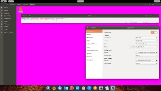

it should be eaiser to acheive with ~/.config/gtk-3.0/gtk.css but in my trail it is also changing and locking the desktop background.
So below is the workaround.
create the file gtk.css with below content
@import url("/usr/share/themes/Ambiance/gtk-3.20/gtk.css");
.nautilus-window { background-color: yellow; }
place this gtk.css file in the blow path.. create the directory's as necessary..
~/.themes/YELLOW/gtk-3.0/
choose this Application theme called YELLOW from gnome-tweaks or via command line..
logout and logback in may be necessary..

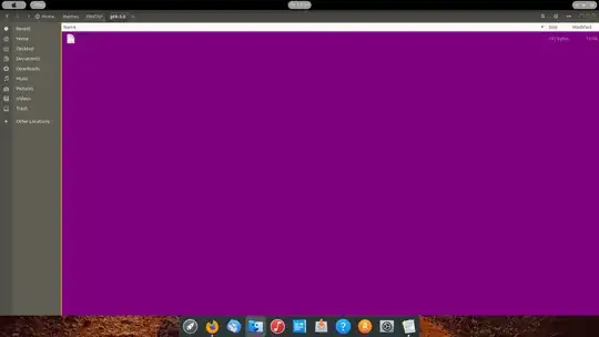

Edited Code:
.nautilus-window .view { background-color: purple; }
