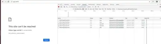

But to my surprise, now I'm not able to see my webpage anymore, even if, apparently, everything seems ok. " This site can’t be reached https://ggc.world/ is unreachable. ERR_ADDRESS_UNREACHABLE " : enter image description here

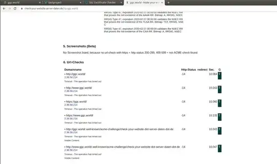

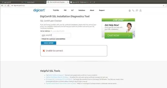

And this is remarked with the digicert's and check-your-website-server's checks: enter image description here
But apparently seems everything ok:

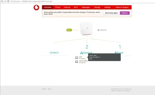

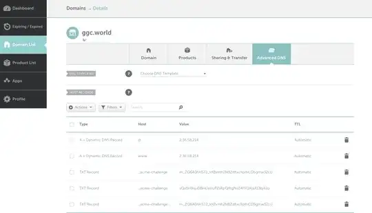

Before trying to access the website, I cleaned all the content of the web-browser's cache and history. The only Google Chrome's extension installed is Vue.js devtools
The DNS provider configuration matches with the Internet Service Provider configuration:
enter image description here The internet connection is working fine.

Big Update:SOLVED (but still do not know why)...
I fixed the PC's IP Address, and everything went fine.... But I do not actually understand why everything went fine, if, before the problem with the software installation, the local ip address was dynamic and it was already working fine.
