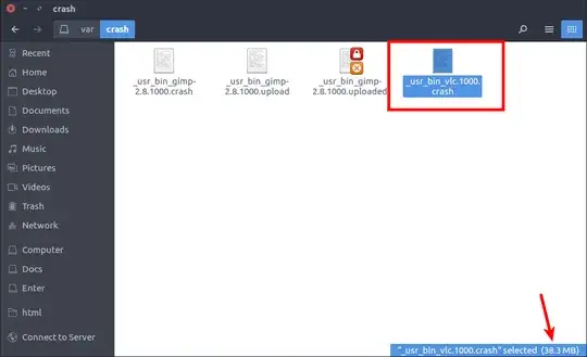

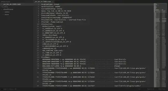

The .crash file under /var/crash is a simple text file, just a really big text file. Any text editor can open it but preferably look for a text editor capable of opening large files.
I have been able to open one that is 38.3 Mbs using Sublime Text 3.
