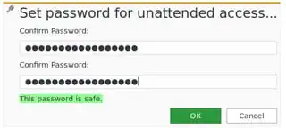

  4. Set password and click OK button
    Anydesk unattended access password setting

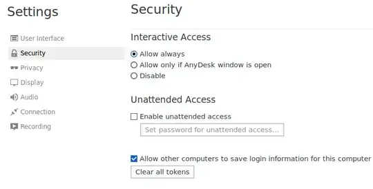

But after OK button clicking Unattended Access settings have not been changed:
Anydesk settings after OK button clicking

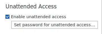

Enabled unattended access picture
Updated: In current Anydesk 5.5.5 version run in terminal:
$ anydesk-global-settings
Then enter your current user password and set Unattended access. Now it saves it.
