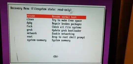

I finally tried what I saw as a risky strategy, since little was really working:
I rebooted and when the splash screen appeared I typed &ltesc&gt until I got a menu offering GNU GRUB options.
I chose 'Advanced options for Ubuntu.
This offered both available kernels in normal and (Recovery Mode) I chose Recovery Mode for the latest kernel, the one that froze after a few seconds.
I was now taken to a screen offering several choices. (see attachment).
I used: fsck - Check all file systems, then grub - Update grub boot loader, then dpkg - Repair broken packages. Followed by resume - Resume normal boot which booted to the server but not normally so I rebooted completely with sudo shutdown -r now. This b0oted the latest kernel: 4.15.0-76.86 and thus far it has worked without issue.
Hopefully this will help other idiots like myself facing issues that could really hurt the business they are using the server for.
MickG
