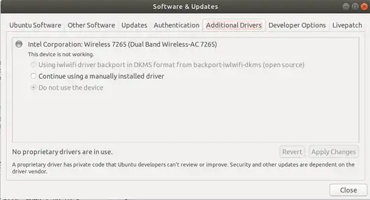

The title is self explanatory, basically, when I go to a freshly installed Ubuntu 18.04's Additional Drivers I'm seeing this:
Printscreen
I have been searching online and tried two things:
  • Disable "fast startup" on my windows (installed as dualboot)
  • Downloaded and copied to /lib/firmware/ the "IntelĀ® Dual Band Wireless-AC 7265" drivers in this link
However, the issue persists. My internet seems to work fine so far, although sometimes after hibernation, it does not connect to very specific networks and I need to restart my laptop. I think I have everything updated as my kernel (as seen in the output of uname -a) is 5.3.0-28-generic.
Any ideas of what else I can do? I admit I don't have much practice with dealing with drivers in linux.

A launchpad bug was submitted to for this issue with software-properties-gtk (Software & Updates GUI). https://bugs.launchpad.net/ubuntu/+source/software-properties/+bug/1859308
If you login to Launchpad.net, and claim the bug affects you, you can raise the bug heat. The higher the bug heat, the more attention the bug receives. https://blog.launchpad.net/bug-tracking/bug-heat
I have this issue on two separate computers, Dell Precession 7520 running clean 19.10 and OnLogic Karbon 300 running 18.04. Both computers WiFi and Bluetooth are working perfectly fine.
