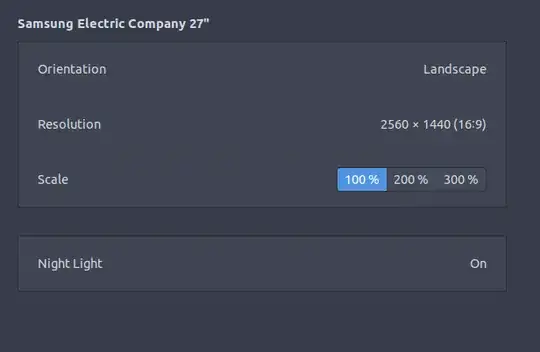

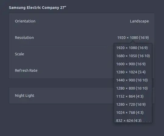

As this monitor has a HDMI cable and the laptop has only Display port, I am using a DisplayPort to HDMI adapter. Everything worked until recently (I was able to set 2560x1440 resolution without any problem). Cable is probably old and it started to disconnect and connect quite often (turning the screen off for few seconds). I decided to get a new adapter so I got ICY BOX (up to 4K resolution, they say).
It is already the second one I am trying but I am not able to select higher resolution with it than 1920x1080:
But I am able to do that with an old cable which is constantly reconnecting:

With old adapter (has 2560x1440 but old and needs to be replaced):
matt:~ $ xrandr --listmonitors
Monitors: 1
 0: +*DP-3 2560/597x1440/336+0+0  DP-3
matt:~ $ xrandr -q
Screen 0: minimum 320 x 200, current 2560 x 1440, maximum 8192 x 8192
LVDS-1 connected (normal left inverted right x axis y axis)
   1600x900      60.04 +  59.99    59.94    59.95    59.82    40.02
   1440x900      59.89
   1400x900      59.96    59.88
   1440x810      60.00    59.97
   1368x768      59.88    59.85
   1360x768      59.80    59.96
   1280x800      59.99    59.97    59.81    59.91
   1152x864      60.00
   1280x720      60.00    59.99    59.86    59.74
   1024x768      60.04    60.00
   960x720       60.00
   928x696       60.05
   896x672       60.01
   1024x576      59.95    59.96    59.90    59.82
   960x600       59.93    60.00
   960x540       59.96    59.99    59.63    59.82
   800x600       60.00    60.32    56.25
   840x525       60.01    59.88
   864x486       59.92    59.57
   800x512       60.17
   700x525       59.98
   800x450       59.95    59.82
   640x512       60.02
   720x450       59.89
   700x450       59.96    59.88
   640x480       60.00    59.94
   720x405       59.51    58.99
   684x384       59.88    59.85
   680x384       59.80    59.96
   640x400       59.88    59.98
   576x432       60.06
   640x360       59.86    59.83    59.84    59.32
   512x384       60.00
   512x288       60.00    59.92
   480x270       59.63    59.82
   400x300       60.32    56.34
   432x243       59.92    59.57
   320x240       60.05
   360x202       59.51    59.13
   320x180       59.84    59.32
VGA-1 disconnected (normal left inverted right x axis y axis)
HDMI-1 disconnected (normal left inverted right x axis y axis)
DP-1 disconnected (normal left inverted right x axis y axis)
HDMI-2 disconnected (normal left inverted right x axis y axis)
HDMI-3 disconnected (normal left inverted right x axis y axis)
DP-2 disconnected (normal left inverted right x axis y axis)
DP-3 connected primary 2560x1440+0+0 (normal left inverted right x axis y axis) 597mm x 336mm
   2560x1440     59.95*+
   1920x1080     60.00    50.00    59.94
   1680x1050     59.88
   1600x900      60.00
   1280x1024     75.02    60.02
   1440x900      59.90
   1280x800      59.91
   1152x864      75.00
   1280x720      60.00    50.00    59.94
   1024x768      75.03    70.07    60.00
   832x624       74.55
   800x600       72.19    75.00    60.32    56.25
   720x576       50.00
   720x480       60.00    59.94
   640x480       75.00    72.81    66.67    60.00    59.94
   720x400       70.08
  2560x1440_60.00 (0x18b) 312.250MHz -HSync +VSync
        h: width  2560 start 2752 end 3024 total 3488 skew    0 clock  89.52KHz
        v: height 1440 start 1443 end 1448 total 1493           clock  59.96Hz
With new adapter (the one without 2560x1440 resolution):
Monitors: 1
 0: +*HDMI-3 1920/597x1080/336+0+0  HDMI-3
matt:~ $ xrandr -q
Screen 0: minimum 320 x 200, current 1920 x 1080, maximum 8192 x 8192
   1440x900      59.89
   1152x864      60.00
   960x720       60.00
   928x696       60.05
   896x672       60.01
   960x600       59.93    60.00
   840x525       60.01    59.88
   864x486       59.92    59.57
   800x512       60.17
   700x525       59.98
   800x450       59.95    59.82
   640x512       60.02
   720x450       59.89
   700x450       59.96    59.88
   640x480       60.00    59.94
   720x405       59.51    58.99
   684x384       59.88    59.85
   680x384       59.80    59.96
   640x400       59.88    59.98
   576x432       60.06
   512x384       60.00
   512x288       60.00    59.92
   480x270       59.63    59.82
   400x300       60.32    56.34
   432x243       59.92    59.57
   320x240       60.05
   360x202       59.51    59.13
   320x180       59.84    59.32
HDMI-3 connected primary 1920x1080+0+0 (normal left inverted right x axis y axis) 597mm x 336mm
   1920x1080     60.00*   50.00    59.94
   1680x1050     59.88
   1600x900      60.00
   1440x900      59.90
   1280x800      59.91
   1152x864      75.00
   832x624       74.55
   720x576       50.00
   720x480       60.00    59.94
   720x400       70.08
DP-3 disconnected (normal left inverted right x axis y axis)
