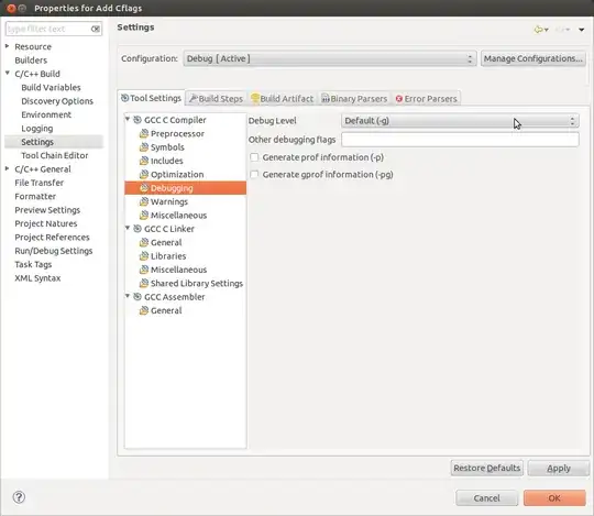

Let's take that apart: -g Default debug level so
Project Properties->C/C++ Build->Settings->Tool Settings->Debugging and select Debug Level Default (-g)

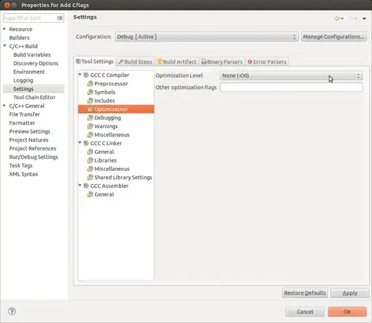

-O0 Optimization level so
Same tab Optimization None(-O0)

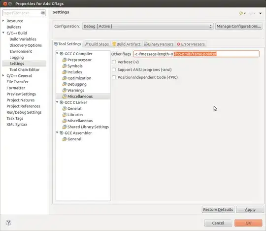

-fno-omit-frame-pointer so
Same tab Miscellaneous Other flags add -fno-omit-frame-pointer enter image description here

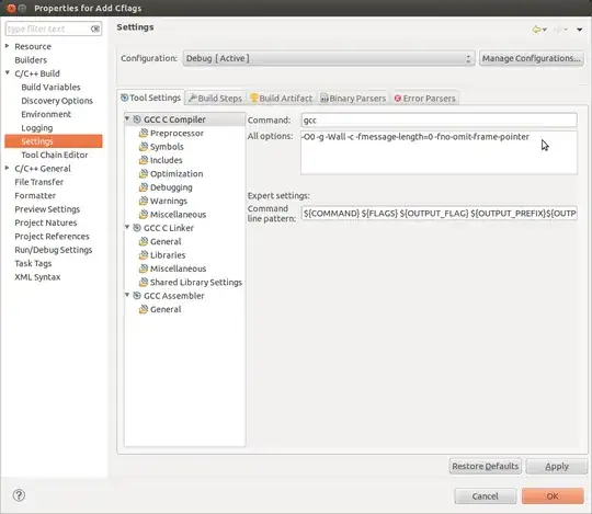

So you check in gcc c compiler and it looks like this
Apply and OK.
