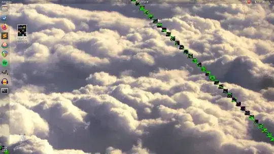

At the same time, I'm having an issue with HDMI, which seems to have caused a bizarre glitch in my wallpaper (and sometimes with all GNOME menus):
desktop printscreen
What could be causing this and how to fix it?
