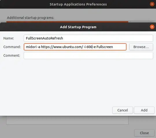

  1. Install Midori
  2. Open Startup Applications
  3. Click Add
  4. Add Command midori -a https://www.ubuntu.com/ -i 600 -e Fullscreen
    Startup Program
  5. Click Add
Source
