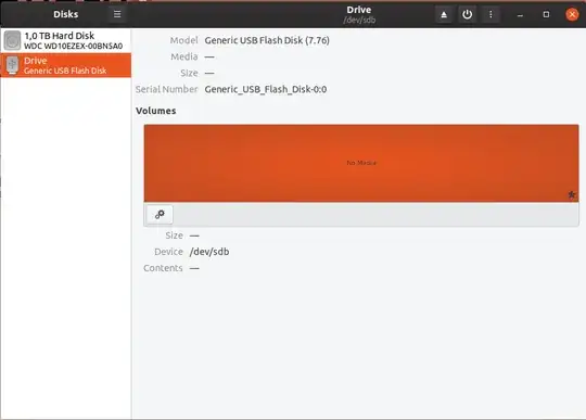

I tried to make a bootable windows drive with a 16GB flash drive and an error occurred making the drive unrecognizable by the system. I've tried all ports of the pc and not worked, tried all ports in another computer and nothing. The GParted not recognize it too.

Disks screen:
The drive is bootable but when I start the pc, the grub recovery opens and says that the file system is unknown. Typing ls shows some partitions like (hd,msdos5) and (hd,0). Typing ls (hd,msdos5) shows that it is ext4 but with hd,0 is unknown. Can someone help me figure how to format it?

The fact that the pendrive is still bootable and in the grub rescue the ls command list some of it's partitions I believe that it is still alive. But the system or any tool can't see it. Only the lsusb and drivers see the device. Maybe there is another way to format the pendrive.

Thanks for showing the output of lsblk.
/dev/sda5 has an ext4 file system and it is the root partition. But after that I see nothing. I had hoped to see the partitions of the USB pendrive. Maybe the pendrive was no longer plugged in.
Anyway, I have used woeusb with good results (to create USB install drives for Windows 10). See the following link
WoeUSB Error Code 256 with NTFS formatted USB
Please notice that I used and recommend sudo.
I suggest that you try again. This time, do not unplug the drive directly. Instead, when woeusb has finished
  • Run the command sync and wait for it to finish (when the terminal window returns to prompt).
  • Unmount the drive
    sudo umount /dev/sdX*
    where X is the device letter from the USB pendrive, for example b, so in that case /dev/sdb*
After that you should be able to unplug the pendrive and use it to boot another computer.
If this does not work, you had better check if the pendrive is good or bad. You can analyze the status of the pendrive according to the following link
Can't format my usb drive. I have already tried with mkdosfs and gparted - the answer "Analysis ..."
