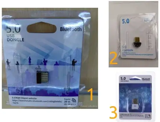

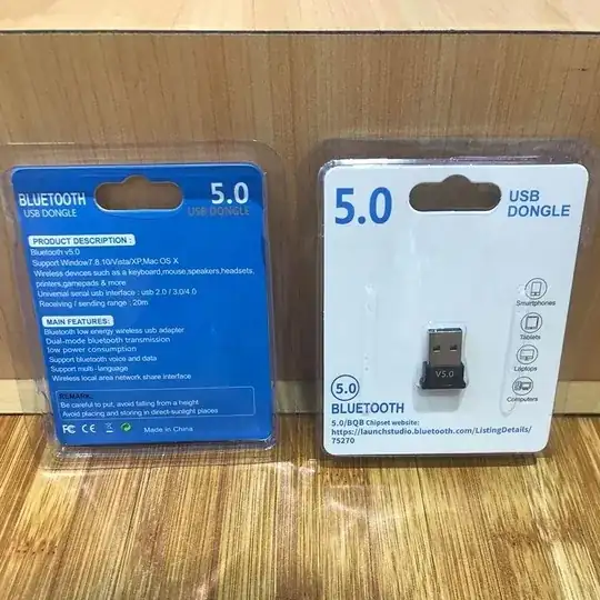

It is about this one: https://launchstudio.bluetooth.com/listingdetails/75270 And likely relevant chip(s) are: http://en.barrot.com.cn/a/BR80XX-series/48.html and http://en.barrot.com.cn/a/BR200Xxilie/12.html
Note: I was asked by @Pilot6 to create this as a separate question to avoid that my previous comments (added as an answer in the question referred to in the start) will get deleted.
Images found on the Internet that matches specific 'BQB 75270' LMP Subversions (identified by user):
LMP Subversion (a.l): 0x1113
LMP Subversion (BXL - product 3 in image below): 0x1712
LMP Subversions currently unknown for products 1 and 2 below.
Click for larger image: Other BQB75270 dongles
