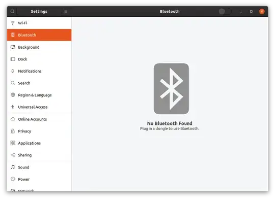

I recently installed ubuntu 19.10 and since then I have not been able use bluetooth on my laptop.
$ bluetoothctl
Agent registered
[bluetooth]# show
No default controller available
I ran the following command.
lspci -nnk | grep -iA3 net; lsusb; dmesg | egrep -i 'blue|firm'
which gives the following result. I can't understand this. Please help.
