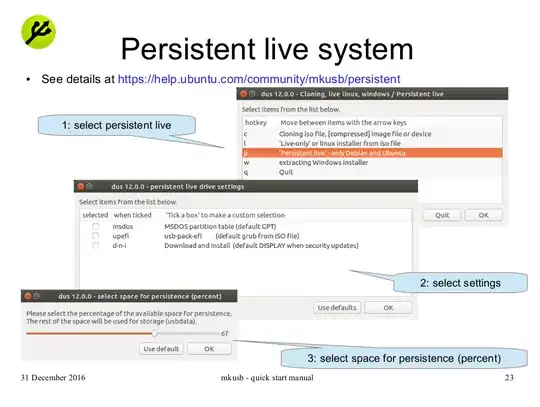

Persistent live drive
  • If you want a persistent live drive with Ubuntu, you can use mkusb. It works with all current versions of Ubuntu and the Ubuntu family flavours.
    You can create a partition for persistence with the file system ext4 and the label casper-rw and a partition for storage and transport of data with the NTFS file system and the label usbdata. You can decide the percentage of the remaining drive space (after the system is installed) to use for persistence (and indirectly how much for usbdata).

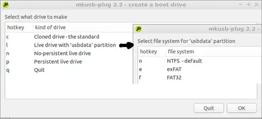

Live drive with storage
  • With Ubuntu 19.10 and later on with the next LTS release, 20.04, you can also make a live (live-only) drive with mkusb-plug, and use the remaining drive space behind the system for storage and transport of data with the NTFS, FAT32 or exFAT file system and the label usbdata.
