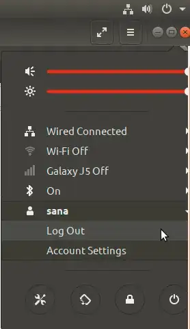

By log out, I mean pressing log out button (image), not lock-screen (super+L) enter image description here
