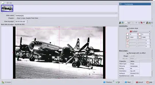

Here are a couple of screenshots from my desktop:
enter image description here This is the main GUI with the timeline and all the toolbars shown.
enter image description here This is the "Slide Properties" Window, on which you can define certain parameters, such as the slide duration, pan, crop and other properties. You can access this feature by double-clicking on the slide when in the timeline.

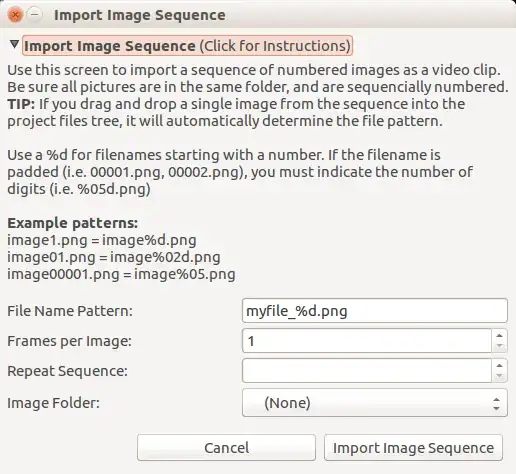

Another option is OpenShot video editor. It is in the repositories.
File > Import Image Sequence
