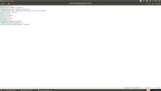

Open the file gnome-flashback-nm-applet.desktop with below command
sudo -H gedit /etc/xdg/autostart/gnome-flashback-nm-applet.desktop
and edit the content like below
[Desktop Entry]
Name=Network (GNOME Flashback)
Comment=Manage your network connections
# TRANSLATORS: Don't translate this text (this is icon name)
Icon=nm-device-wireless
Exec=nm-applet
TryExec=nm-applet
Terminal=false
Type=Application
NoDisplay=true
OnlyShowIn=noGNOME-Flashback; ### I have changed this line. ###
X-GNOME-UsesNotifications=true
X-Ubuntu-Gettext-Domain=gnome-flashback
for user only:
cp /etc/xdg/autostart/gnome-flashback-nm-applet.desktop ~/.config/autostart/
and edit the file ~/.config/autostart/gnome-flashback-nm-applet like below
