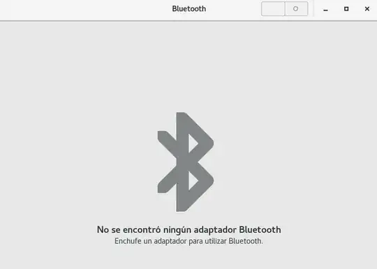

I'm using Ubuntu 18.04 on HP 240 G7 and bluetooth is not working. Says "no adapters found" and the switch is grayed out.
bt config
These are some command outputs I've run:

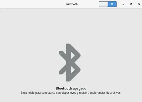

EDIT AFTER ANSWER
Now bluetooth keeps telling it's off even if I turn it on. enter image description here
