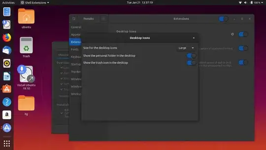

icons with "large" setting

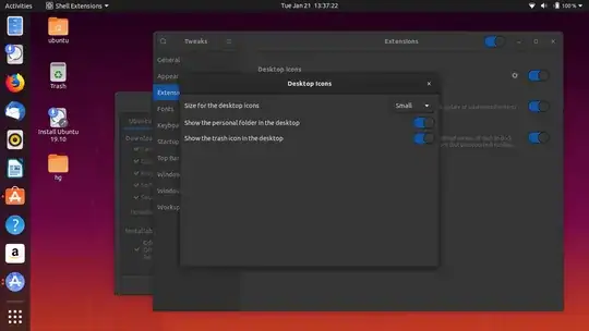

icons with "small" setting

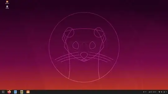

Update: Works very well, the screenshot shows the final result:
icons with custom settings
