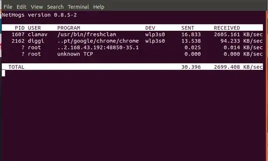

Freshclam is the clamav database updater.  You can reduce the amount of times that it goes out and updates the clamav database anywhere from 0 times a day (no updates) to however many you want.  12 times a day means once every 2 hours.  Right now, it is probably set to 24 times (once per hour).

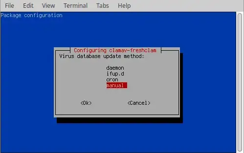

To set it run:
sudo dpkg-reconfigure clamav-freshclam
You can also set freshclam to a manual update by setting the Virus database update method: on the second screen of sudo dpkg-reconfigure clamav-freshclam to manual.
After the above is set, then simply run sudo freshclam to update:
